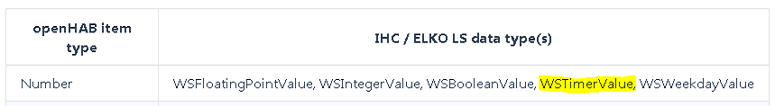

0 Ole Posted June 22, 2018 Author Report Share Posted June 22, 2018 7 minutter siden, Kandersen skrev: jeg vil tro den skal defineres som en NUMBER Det skal den i følge dokumentationen, så det har jeg gjort. ;-) https://www.openhab.org/addons/bindings/ihc1/#item-configuration Mit item er defineret således: Number U_TimerVand "Timerværdi for vanding [%.0f]" <time> {ihc="<0x1102410"} Hvis jeg udlæser U_TimerVand via sitemap, er den 0, uanset timeren er under nedtælling eller ej. Jeg spekulerer lidt i, om IHC typen Time er den rette at bruge. Der er jo også typen med benævnelsen TimerTid, uden jeg er helt skarp på funktion og forskel. /Ole Quote Link to comment Share on other sites More sharing options...

0 Pauli Anttila Posted July 5, 2018 Report Share Posted July 5, 2018 (edited) Some reason Google translator translate pretty "bad" english, so it's pretty hard to fully understand what you try to reach on your example. Anyhow, following configuration is read only from openHAB perpective, meaning that only timer value change in IHC is updated to openHAB item. Number U_TimerVand "Timerværdi for vanding [%.0f]" <time> {ihc="<0x1102410"} So if you change the U_TimerVand item value, it will not be updated to IHC. When every timer value is changed in IHC side (timer is running or you change it via service view), value is updated to openHAB item. Timers are in millisecond resolution in IHC, so I guess that, if timer is running, you will get a lot of updates. Maybe not every millisecond, but very often. So most probably it's not wise to sync timer value between openHAB and IHC. If you just want to change the timer value from openHAB to IHC, you could make it write only (>). If you want to know when timer is expired (counted to 0), your most probably should change the IHC code so that when timer is expired some kind of flag is set, which change is then syncronized to openHAB. Syntax explanation: Syncronization in both directions (IHC <-> openHAB): Number U_TimerVand "Timerværdi for vanding [%.0f]" <time> {ihc="0x1102410"} Read only (IHC -> openHAB): Number U_TimerVand "Timerværdi for vanding [%.0f]" <time> {ihc="<0x1102410"} Write only (openHAB -> IHC): Number U_TimerVand "Timerværdi for vanding [%.0f]" <time> {ihc=">0x1102410"} Edited July 5, 2018 by Pauli Anttila Fixed examples Ole 1 Quote Link to comment Share on other sites More sharing options...

0 Ole Posted July 5, 2018 Author Report Share Posted July 5, 2018 @Pauli Anttila I think you understand my needs. I wish to adjust IHC timer values from OpenHAB. Regarding the IHC "Timer" tag, it represents the actual value counting up / counting down when the timer is activated. It generates a lot of updates when an OpenHAB item is bound to the tag, and I'm sure that you are right, when telling it's not wise to do so. And either, it is not my need. That is why I am playing with the IHC "TimerTid" tag. If I understand you correct, the only thing I have to change is to add a ">" to the item definition so its like: Number U_TimerVand "Timerværdi for vanding [%.0f]" <time> {ihc=">0x1102410"} I will try that tonight. Thanks a lot. 5 timer siden, Kandersen skrev: Isn´t the item defintion suppose to be DateTime ?? Not according to the documentation, if I understand it correct, please have a look on my second post. BR Ole Quote Link to comment Share on other sites More sharing options...
