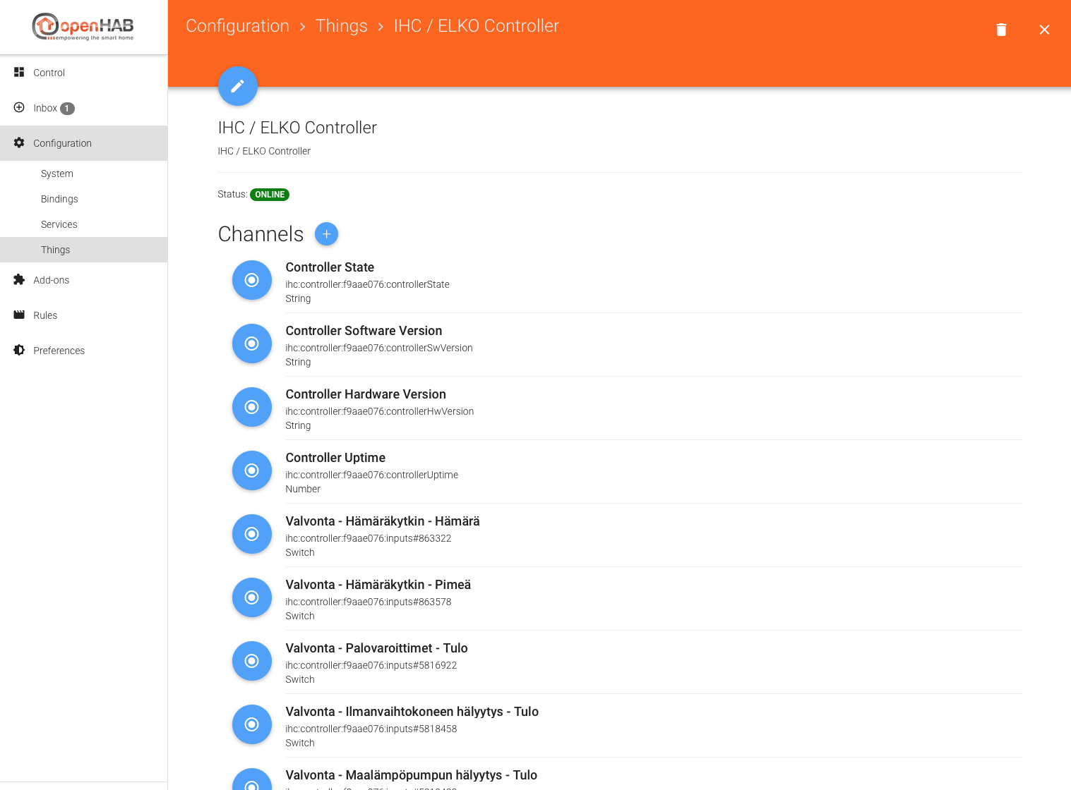

Some improvements / features:
  • By default, binding create channels automatically from project file (currently all dataline_inputs, dataline_outputs, airlink_inputs, airlink_outputs and resource_temperature).
  • Auto creation can be disabled, and channels can be created manually (then all resource id's are supported).
  • Support both Paper UI and thing files configuration.
  • Channels for basic controller information (state, SW and HW version, controller uptime, etc).
  • Trigger channels support (button short press, long press and extra long press).
  • Support multiple controllers (those who have e.g. two controllers environment).

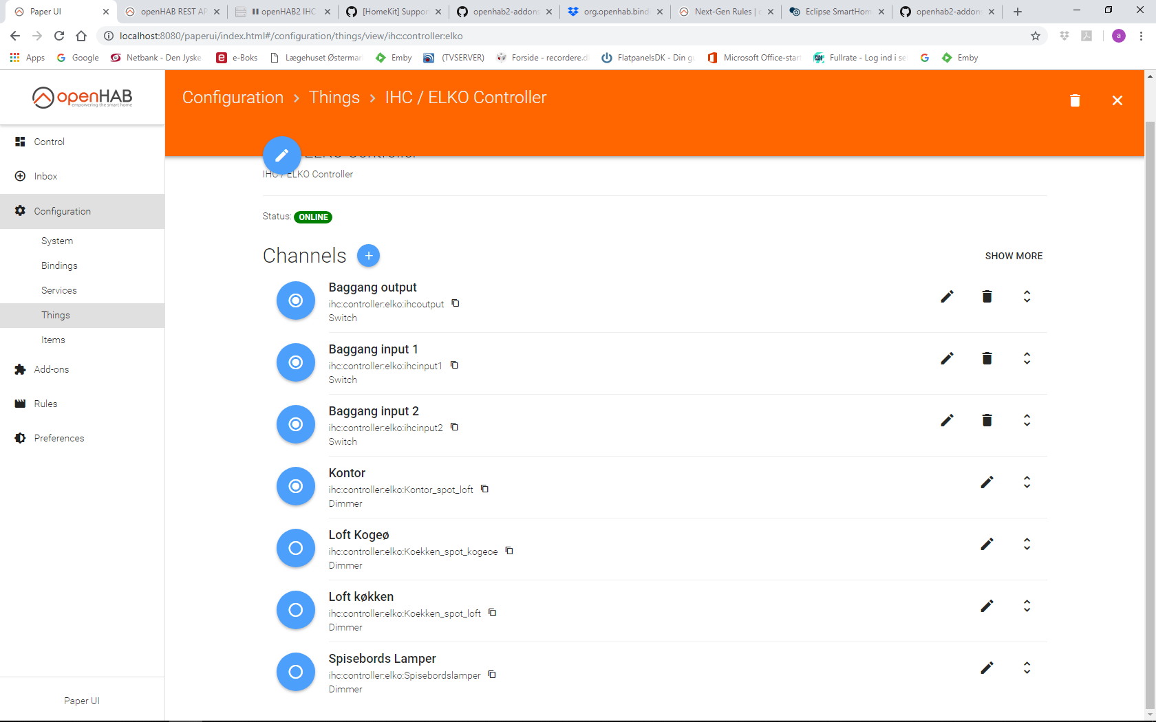

Hej beklager jeg skriver på dansk men mit skriftlige engelsk er for dårlig.
Jeg har også været ved at lege lidt med den nye version, men det er kun de trådløse tryk som bliver fundet hos mig, ingen lysdæmpere men jeg kan tilføre dem manuelt ved at lave en ihc.things fil som denne:
ihc:controller:elko [ ip="192.168.8.200", username="admin", password="xxxxx", timeout=5000, loadProjectFile=true, createChannelsAutomatically=false ] {
Channels:
Type switch-channel : ihcoutput "Baggang output" [ resourceId=1024347, direction="ReadOnly" ]
Type switch-channel : ihcinput1 "Baggang input 1" [ resourceId=5394012, direction="WriteOnly", pulseWidth=1000, commandToReact="ON" ]
Type switch-channel : ihcinput2 "Baggang input 2" [ resourceId=5394268, direction="WriteOnly", pulseWidth=1000, commandToReact="OFF" ]
Type dimmer-channel : Kontor_spot_loft "Kontor" [ resourceId=2540893 ]
Type dimmer-channel : Koekken_spot_kogeoe "Loft Kogeø" [ resourceId=2549085 ]
Type dimmer-channel : Koekken_spot_loft "Loft køkken" [ resourceId=2545757 ]
Type dimmer-channel : Spisebordslamper "Spisebords Lamper" [ resourceId=3190365 ]
Hvor efter de fint kommer frem i Paper UI
Og kan derefter enten lave en manuel ihc.items fil some denne:
//This is the item file
Switch Baggang_spot "Lys i baggang" <Light> ["Lighting"] {channel="ihc:controller:elko:ihcoutput", channel="ihc:controller:elko:ihcinput1", channel="ihc:controller:elko:ihcinput2"}
Dimmer Kontor_spot "Lys i kontor" <Light> ["Lighting"] {channel="ihc:controller:elko:Kontor_spot_loft"}
Dimmer Kogeoe_spot "Spot kogeø" <Light> ["Lighting"] {channel="ihc:controller:elko:Koekken_spot_kogeoe"}
Dimmer Koekken_spot_loft "Spot loft køkken" <Light> ["Lighting"] {channel="ihc:controller:elko:Koekken_spot_loft"}
Dimmer Spisebordslamper "Lys over spisebord" <Light> ["Lighting"] {channel="ihc:controller:elko:Spisebordslamper"}

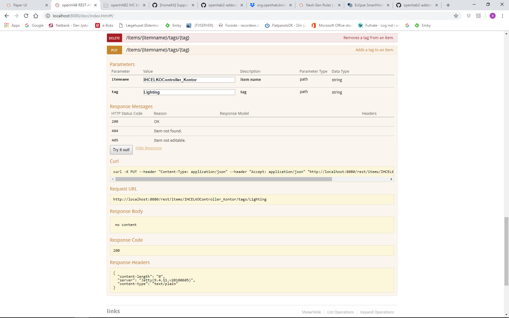

eller bruge Paper UI metoden og dernæst ved hjælp af OpenHAB REST API Documentions tagge items
Men når jeg beder sire eller google assistent om at tænde for lysene, tænder de godt nok men på det laveste mulige blus, hvorefter jeg skal bede dem om at skue helt op for lyset.
Laver jeg mine items rigtig?
Skal jeg lave en regel for at få lyddæmperne til at tænde på 100 %?
