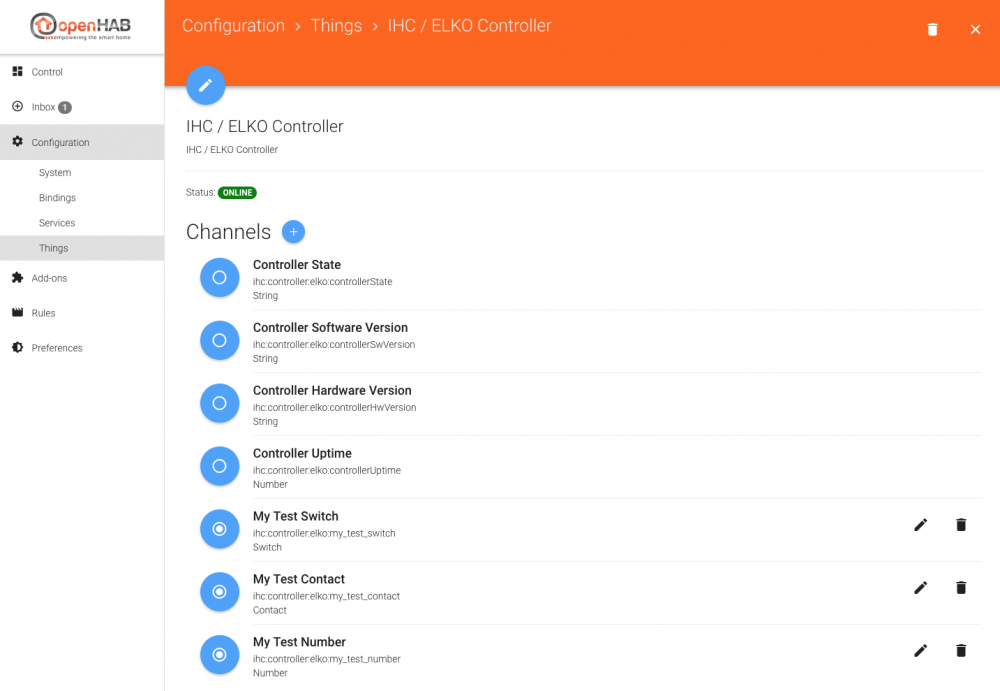

Or you can manage things and channels via things file (e.g. ihc.things)
ihc:controller:elko [ ip="192.168.1.2", username="openhab", password="openhab", timeout=5000, loadProjectFile=true, createChannelsAutomatically=false ] {
    Channels:
        Type switch-channel : my_test_switch "My Test Switch" [
            resourceId=3988827
        Type contact-channel : my_test_contact "My Test Contact" [
            resourceId=3988827
        Type number-channel : my_test_number "My Test Number" [
            resourceId=3988827
which will look like following
5b05c9f2a8400_ScreenShot2018-05-23at22_47_54.thumb.png.7a6992f649654a728019c774d622960b.png
5b05c9f908988_ScreenShot2018-05-23at22_48_06.png.84156d2eccd02a82a2002182d93ba5d2.png
