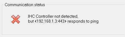

When trying to connect with Visual, I always get the same message :
And IHCStarter doesn't manage to connect neither:
All work in USB though.
PS: I have tried on multiple PC's now, and it always gives the same result.
