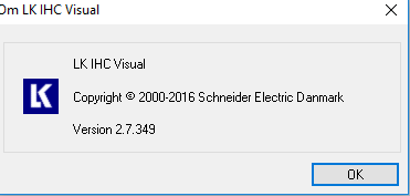

I am trying to download the VIS file from 6.1 controller with correct LK IHC Visual. I get the error message, file error this is not a VIS file or the file is damaged.
The scenedesign works fine to connect but just the access / download of the project file is an issue. Any proposal how to access?

Are you sure the IHC firmware and IHC Visual version are compatible?
Yes Completely, firmware is latest in controller and the lK firmware is 2.7.220
