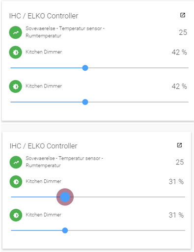

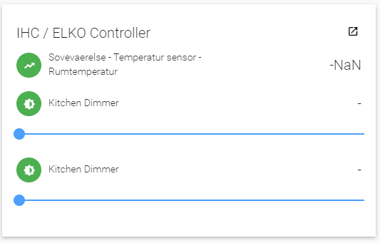

0 kerm Posted October 15, 2019 Author Report Share Posted October 15, 2019 Hi I have just now flashed the PI with this image openhabian-pi-raspbian-201908050414-gitca0976f-crc6a66b5a1.img then I putty into it and use the guide https://knab183.wordpress.com/2018/11/03/installing-and-using-ihc-bindings-on-openhab2/ I then added 2 dimmers to an item and a temp sensor to another item, then Sudo Reboot After the reboot I get this PS by the way it was not happy with æøå only the first time I loaded from ICH after it restarted if could not understand æøå I therefor renamed all my items in ICH controller events.log openhab.log Quote Link to comment Share on other sites More sharing options...

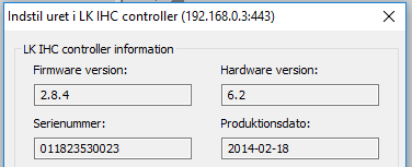

0 Pauli Anttila Posted October 16, 2019 Report Share Posted October 16, 2019 @kerm, communication between openHAB and IHC controller doesn't work very well. Most of the communication ends up to timeout, which means that IHC controller didn't send response to IHC binding. You could try to increase the timeout which is by default 5000ms, but not sure if that will solve your problem. What are your IHC controller HW and SW versions? You are using rather old version of the binding (around 1 year old), so I recommend to use newer one. Quote Link to comment Share on other sites More sharing options...
0 kerm Posted October 17, 2019 Author Report Share Posted October 17, 2019 Hi if i do not reset the PI i am not getting any timeouts and it works fine until i loose power. i have also been running openhab with the version 1 binding for years PS where do i find the latest version of the binding Quote Link to comment Share on other sites More sharing options...
